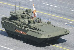

- Well, that BMP T-15 did not have such problems
- As well as the T-14 heavy infantry fighting vehicles T-15 - combat vehicle front edge - this is a very interesting product. Nothing of the kind in the world. Although attempts to create heavy BMP-protected crew compartment at the base of the tank were both here and abroad. For example, in Kharkov, he saw the so-called armored landing capsule to set the train springs creation diy. It looked very funny - sort of like a barn on the tracks. In Nizhny Tagil perform complex development work on the creation of heavy infantry fighting vehicles. I repeat: the first time in the history of the world tank building.
- Rate?
- Some experts argue that the heavy infantry fighting vehicles do not need, because not all tasks can execute. For example, to overcome water obstacles. With aerotransportabelnostyu problems too - on each machine on the aircraft. A further claim that the speed of the T-15 is less than a light armored vehicles. Moreover, I note that with proper organization of the march T-15 at an average speed exceeds a certain BMP (simulation result).
- And there is another statement, though the crew in the so-called capsule - like sprats in the bank.
